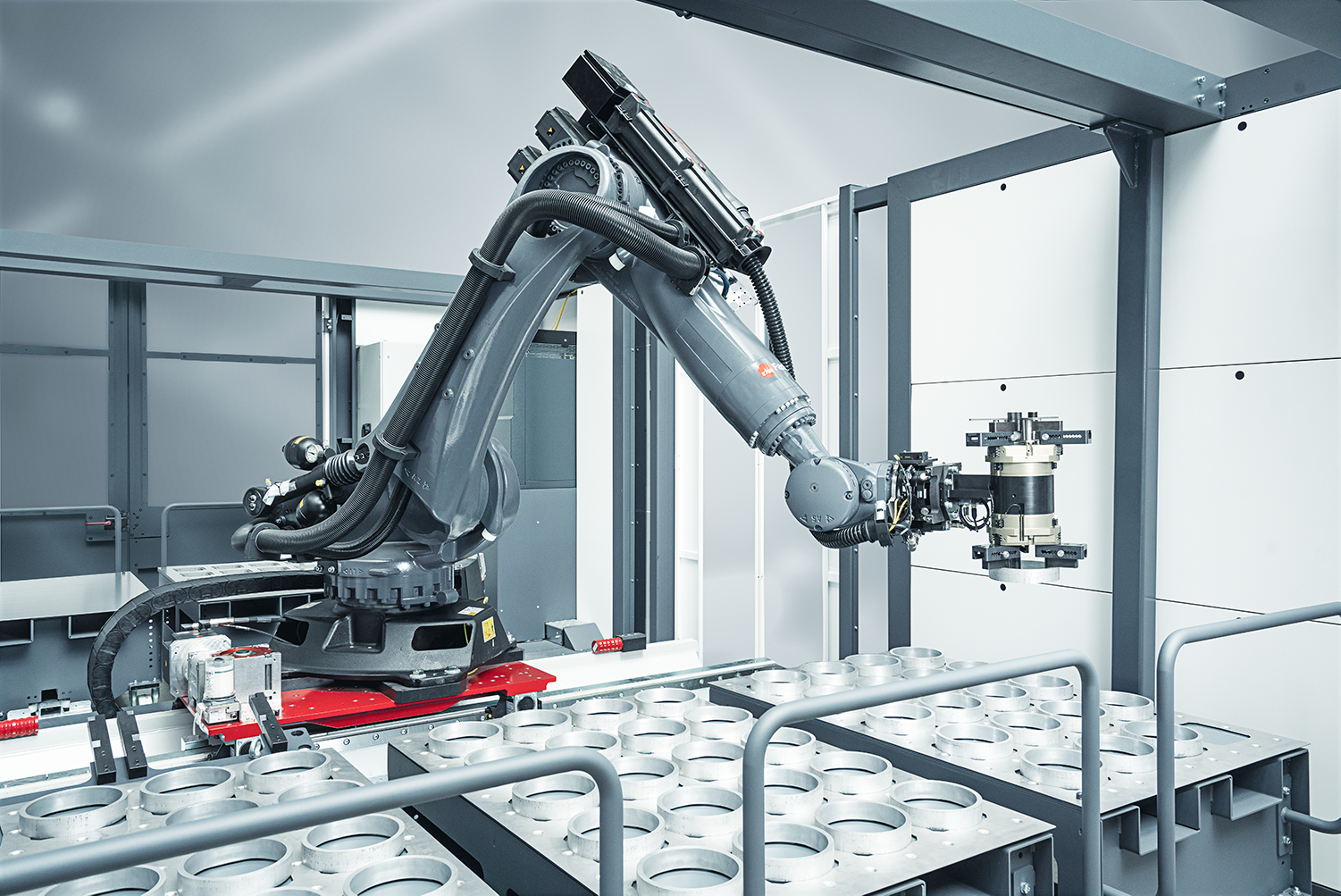

Yes. The RoboCell ONE has a powerful KUKA robot that also covers heavier workpieces. On top of that, it has plenty of reach to serve several kinds of machine tools.
The standard grippers feature adjustable gripper jaws that cover a large range of different gripping dimensions. In case the standard grippers are not suitable for your gripping scenario, it is always possible to customise a gripper for the task in hand.
  1. What part sizes are suitable?
The part weights suitable for the RoboCell ONE are up to 80 kg. The sizes within this weight class vary a lot, but typically parts are roughly 200-300 mm in diameter and 200 mm in height.
