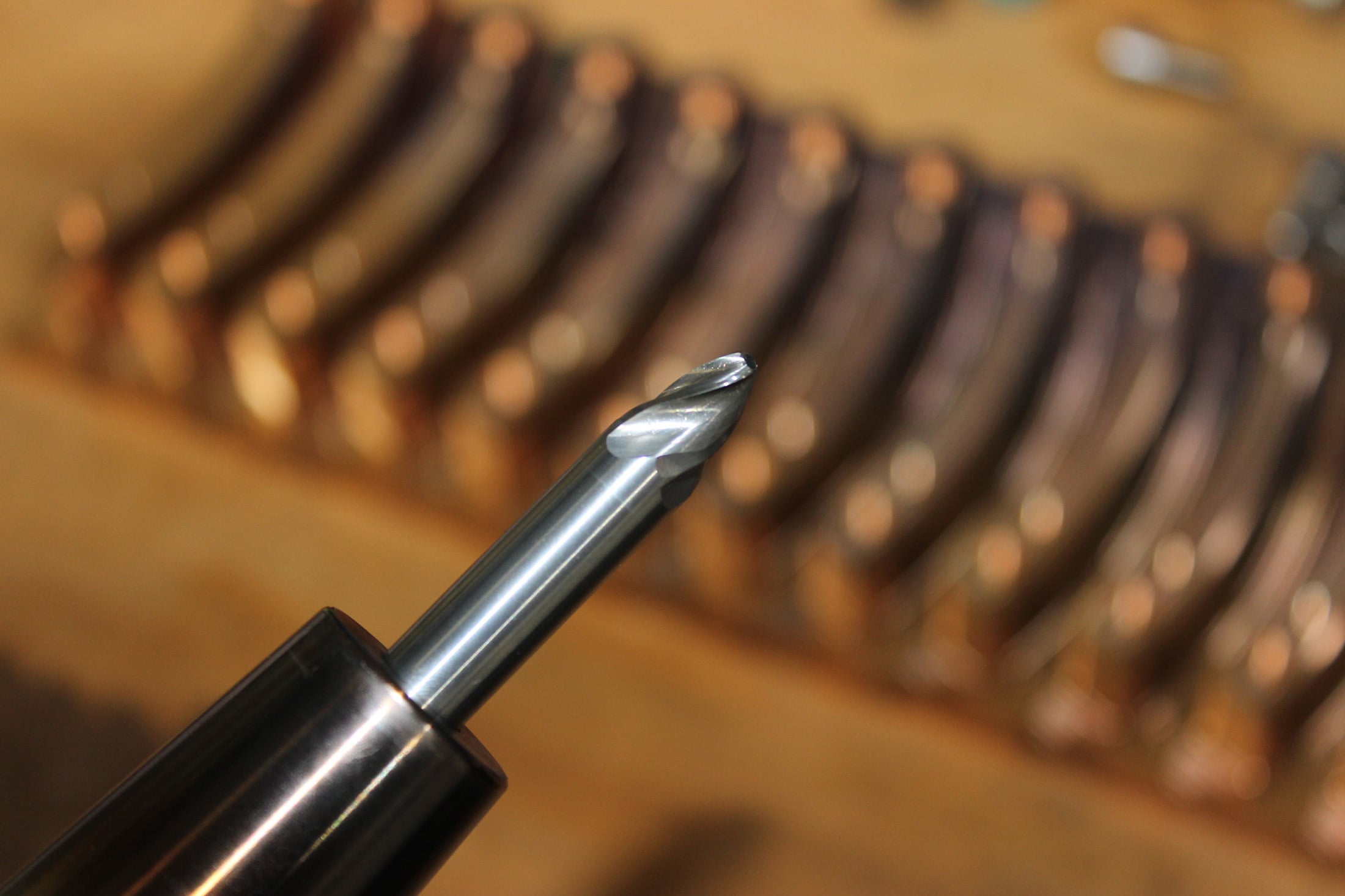

Referring to the success of the barrel tools, Mr Brooker says: “These tools take over from what a ball nose cutter would do on a 5-axis machine. The advantage is the bigger cut area. So, we have reduced our cycle times with the barrel tools by over 20 hours on some jobs and this is machining titanium. That is a massive saving.”
“When anybody comes along and says they can save you 80% of your tool time, you sit there thinking ‘yeah ok!’, but Mike Stobart came in and gave us the tools and it’s safe to say we won’t be going back to our old methods. The tools are absolutely brilliant. Instead of doing 0.8mm step-overs with a ball nose, we are doing 3-4mm step-overs with a barrel tool that gets exactly the same surface finish. On some surfaces, we are holding H7 tolerances with the barrel cutters. You can’t ask for any better.”
